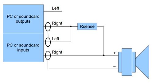

Hi all, I trying to make the jig for the impedance measurement but Im stuck with calibrating because I always have this error... I dont know what seems to be the problem.. I followed this diagram
7,402
The diagram looks wrong, laptop headset inputs usually have a mono mic input and a stereo headphone output and so are not useable for impedance measurement, which requires a stereo input.

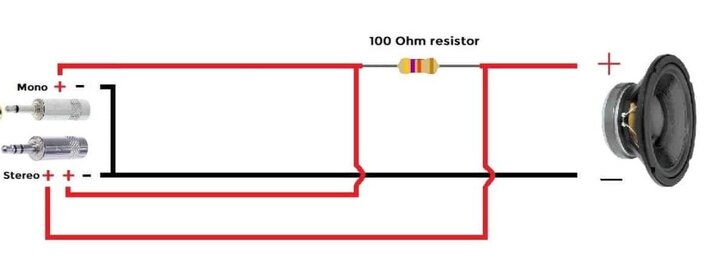

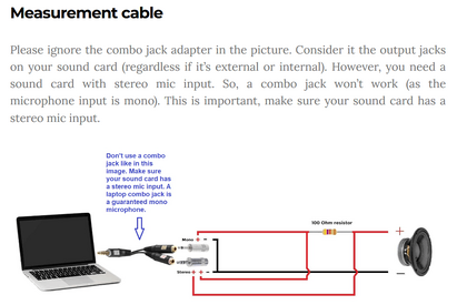

Hi all, I trying to make the jig for the impedance measurement but Im stuck with calibrating because I always have this error... I dont know what seems to be the problem.. I followed this diagram View attachment 64937 View attachment 64938
Hi,
The diagram posted comes from the "Audio Judgement" website.
You need to read the author's article Measure Thiele Small parameters using free software - Audio Judgement and to watch the "Part 2 : UPDATE video".
It should work.

Thanks, I was following the diagram for the cable and using this external soundcard for the input and output.... also tried this diagram from the site and also gives me the same error....

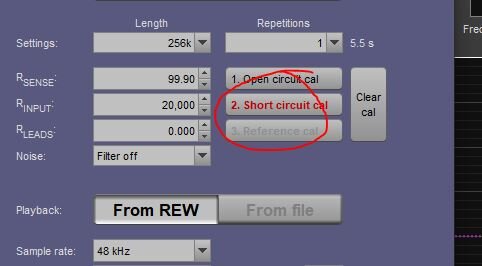

tried swapping loopback but still have the same results and cant go thru number 2 cal.

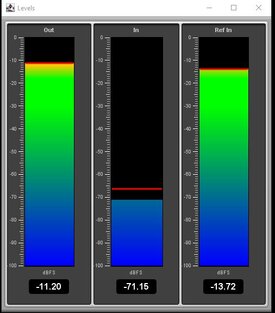

I managed to solved the issues and successfully getting it to work for few weeks and yesterday I cleared cal and tried to calibrate again but now I get lots of errors and cant get pass 1st cal and cant get the input levels the same...
7,402
If that's the open circuit calibration the level should be almost the same on both inputs, which suggests a wiring problem since the measurement input should be getting the same signal as the reference input, just from after the sense resistor.
you're right, I checked the board of my sound card and found out damaged joints , fixed it and its working now.... thank you...:T

I have the same problem with the impedance calibration in rew. I´m using an external soundcard (Behringer UCA 202) ,which i slightly modified, the Arta Box and an old Pioneer A-604R. At the moment I´m not using a microphone, but that should not be any problem. The open circuit calibration works great, but if i make a short circuit calibration, I get an error. Has anyone any idea how I could fix this? I really tried everything and I still have no clue why it´s not working.

Something must be set up wrong. When you do the short circuit measurement the load is shorted, so the measurement input is connected to ground through that short while the ref input gets a direct feed from the output. Since the image you posted shows both inputs have almost exactly the same level the measurement input can't be shorted to ground or the sense resistor isn't in circuit.
