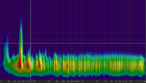

Hello,
I have used REW to take measurements of my room. From what I am seeing in the spectrograph it appears the there are (at least) two problem Hz areas 52 and 85Hz. Based on watching REW Videos part 1 and 2, Bass traps would be required. For reference I have a room that is 2.6m wide 2.4m high and 5.9m long.

You need to check tuned resonators. Most common is Helmholtz resonator.They are bulky, but you can tune them to perfection, as long as you have the proper measurement tools.

Sure, I have a home studio, for recording, mixing and mastering. I am looking to tame some of the low end peaks I have some existing panelling that's appears to flatten frequencies above 220 Hz. However I have measured two peak frequencies at 52 and 85Hz. I see similar results with sonor works measurements.

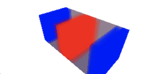

I should add, from plugging into room measurements into the Amroc room calculator, the tool suggested I place some bass traps along my back and wall (which is where my speakers are position).
Attached is the screenshot from the Amroc tool, showing where the frequencies are loudest for the 50-60Hz range.
What is the size of your room. Just to check it coincides with fundamental room modes.
52 and 85 Hz suggest 22' x 13' (6.50m x 4m)
I may be interpolating the frequencies as the problem Hz appear to differ slightly (+/- 5Hz) between REW and Soundworks room measurements

Those tuned Membrane traps are very fickle for location. They might be most effective a few feet off the wall. They require a lot of experimentation and may end up somewhere not expected.

Everything is location dependent in small room acoustics... Speakers, Listening Position, Absorbers, Traps, Diffusors, other hard and/or soft surfaces... Place bass absorbers where 3 surfaces come together and 2 surfaces next... Range limited soffit traps work well... Your trying to tame below the Schroeder frequency where is room is in control... Your .mdats show that the transition zone and above are pretty good...
