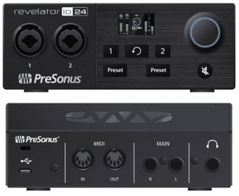

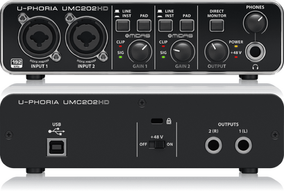

I have a Presonus Revelator IO24 and Behringer UMC 202HD and here comes the problem.
I read in REW manual to calibrate the interface (soundcard) there for I need a cable and
1. I dont understand which one
2. where to connect it for loopback
Can you answer me these two questions? I really new and like to start with this.
Do I need a XLR to 3.5 (6.5mm) cabel which runs from the mic input to one speaker out? And when left or right? Or a XLR to 2x3.5 (6.5)mm?

There is nothing on your devices with a size of 3.5mm. To calibrate the card, the card output must be connected to the card input.
1.This is a TRS 6.5mm to TRS 6.5mm cable.

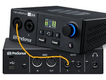

To generate the calibration file, connect the interface’s input and output with a TRS (aka “stereo”) 6.5mm (aka 1/4") cable. The front panel jack is a so-called “combi-jack” that will accept 6.5mm in addition to XLR.

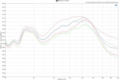

Hope the Behringer EMC 8000 is enough for my purpose. And I get a result like this.
