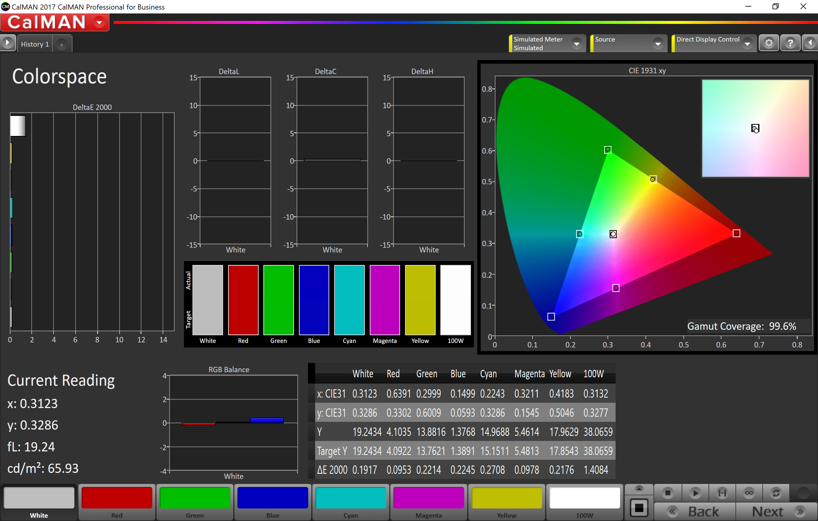

Gamut also consisted of some saturation sweeps:

After Grayscale you then adjust your gamut:
After I adjusted gamut, I then went back and checked everything done previously and fixed anything that may have fell out of line. Here is the final readings from Cinema mode:
