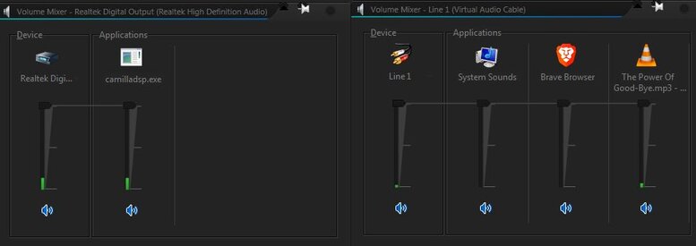

Hi,
CamillaDSP is exactly the type of software that drives me, and many others, insane. Hundreds of pages of documentation and not a single real life working configuration example.
The case is simple: Windows 7 with SPDIF Output.
Does anyone has a working configuration for it before I give up?
So far, here's what I've done:

* why not exclusive access? https://github.com/HEnquist/camilladsp/blob/master/backend_wasapi.md#exclusive-mode
* two different soundcards running asynchronously. Rate adjust is enabled, but no async resampler is configured

Difference in sample rate and dwChannelMask. Samplerate diff is probably unimportant for the shared mode (which works similarly to the plug plugin in alsa).

Whatever works. SPDIF playback is currently set to exclusive access. Kodi likes it like that.

With a resampler defined it still does not start. Thanks for the hint though.

dwChannelMask: 63 would be ok for spdif, 1551 would be 9.1, not supported.

I tried every possible combination of loopback/virtual, shared/exclusive and every time a new error occurs. There are so many variables to setup in windows sound on top of that that it is impossible to get this to work. Wasted 2 more hours and a half on this today. And not advanced an inch. I'm wasting my time. I'm not looking to understand how it works, I've never been interested in Windows, what I need in fact is a valid/working config.

It's not a complex setup, in fact it's a quite straightforward one: Convolver for SPDIF on Win 7. Unfortunately not s single example over the whole net. And there is nothing to be learned when every single edit results in an error.
I got rid of the crappy `CABLE Output (VB-Audio Virtual Cable)` and replaced it with `Virtual Audio Cable` which supports multiple sample rates. It worked flawlessly. One thing to address: when Kodi switches to any 5.1 format, CDSP exits. Higher priority I guess. Therefore I have 2 configs to test. Both are OK for stereo material.
