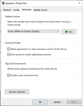

UPDATE: Added Windows Sound setting to the below images

To get MusicBee and Tidal working with EAPO I had to take them both *out* of WASAPI "Exclusive" mode and put them in WASAPI "Shared" mode. So I would assume that somehow REW is in Exclusive mode and that's why it's not working with EAPO. Is there a way to change it somehow to Shared mode? Hmm, I should add my Windows Sound settings to the above set of images. I will take your advice to look for some threads on Exclusive/Shared mode. Thank you for the search pointer! :cool:
