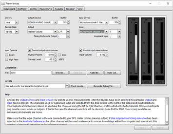

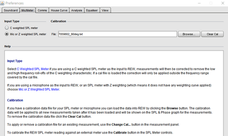

I'm in need of assistance in first time use connecting to my AVR (Denon AVR-X4300H) and using REW 5.19 on Win10 Home to calibrate my speakers 5.1.4. The problem seems to be that I can't get Pink noise to play through my speakers through the AVR? I can see the output when I "Check Levels" but nothing through the speakers... I've browsed around, but a bit overwhelmed and wondering if my Laptop using a USB-C hub is not setup properly or am missing something? Attached are my current preferences in REW 5.19 and the 90deg calibration file is loaded (mic/meter).
I'm a bit confused in that I don't know what is being measured since no pink noise is being played and what is being measured? (attached)

You must install ASIO4All or FLEXASIO and select ASIO for the driver type in order to test individual channels beyond L or R that are supported by the JAVA driver.
