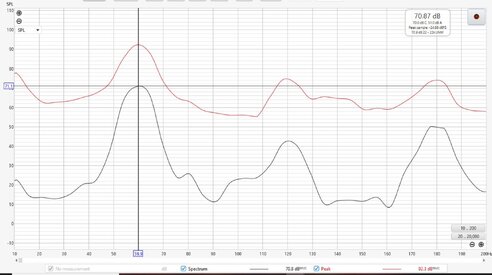

I'm trying to measure my Room using REW.
I got so far as to notice there's a constant 60hz. (from computer I'm guessing) @ about 70db
I've try installing REW on laptop but the 60hz is still there ? So i assume its AC hum ? dirty lines.
Possibly someone could give a look at my data.

Sorry,
My Radio Shack meter is/was the cause. RCA line in on the meter was gootched up!
