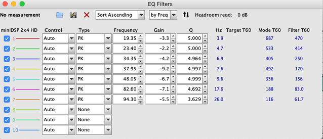

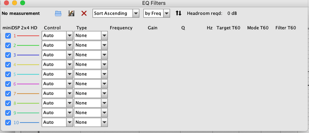

I have no doubt clicked something unintentionally trying to learn the software. Yesterday when I was playing with my MiniDSP and Rew getting readings etc, life was good. Today as I was trying to hone my subs better I lost the EQ filters. When I click EQ and then EQ filters, under type it says none. Under control it says auto. Yesterday, this was not the case. I really hate to be dumb and ask dumb questions but here I am. So, now what?
8,173
You haven't really told us much about what you have been doing. If you transferred filters to the minidsp they are still there and you can view them in the minidsp software. When you make a measurement in REW it doesn't have any filters until you generate some. If you save the measurement afterwards the filters stay with the saved measurement.

You are right, I am not helping you help me. I attached 2 thumbnails. One is blank and when I go to select match response to target, REW tells me it has no filters. This happens even when I load the other thumbnail with filters. I saved those earlier, but I didn't generate those. I think they automatically configured as I adjusted the filter tasks, but now, no matter what task I set, there is no filter. I am not sure I am making any sense.

Filters can only be generated when there is a measurement to generate them for, the filters are to bring the measurement to the target. Load or make a measurement.

I must be missing a step. I take a measurement, go into EQ, set the tasks and it says no filter. I'll go back and watch the video again, there is something I am missing. The best thing is probably to read the manual. Thanks for your feedback.
