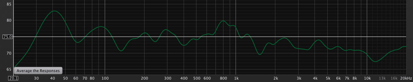

EQ settings setup for SVS sub Parametric EQ.
Paul Anderegg
Jun 7, 2021
6
Yamaha TSR700
Would like suggestions for the proper values to feed into the EQ page in order to better utilize the PEQ of my SVS subwoofer. The SVS has 3 PEQ filters. My Sony AVR is set to 140Hz crossover. Looking to have the EQ generator give me 3 PEQ filters that I can enter into my SVS sub control app. I am not sure how to set up the generic to only return 3 PEQs, and also not sure what values to use for the rest of the fields. Any help greatly apreciated :)
Click the Eq Filters button. Uncheck all filters but 3.
Other than the target level you may not need to adjust anything else.
You can post your REW .mdat file if you want someone to have a look and make a suggestion.

I've got it down to three PEQ now...what values should I put in the target and filter task panel? I saved my pre SVS PEQ sweep...I am assuming I can simply recall that and once I get the panel values set I can generate new PEQ values using the EQ Filters button? Attaching my mdat for the pre PEQ sweep.
