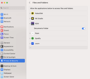

There don't seem to be any errors logged from the V5.20.13 start-ups. Worth checking that REW has permissions to access the relevant folders, including your home folder. The OS may be silently refusing to allow the file dialog if it doesn't like where REW is trying to open it.
How do I check that? I am able to save .mdat files...
I checked and REW has access to my "Documents" folder, where I store all my REW working files. See attached..
