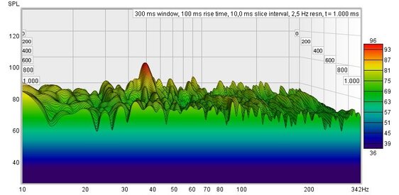

Hello everyone,
could you please have a look at my waterfall diagram?
Am I doing something wrong? This looks a bit strange, the reverberation time seems very long.
Could you please help me out or give me a hint if that could be a correct measurement?
I would really appreciate that. Thanks in advance!
Does nobody has an idea where the problem in my measurement could be?

Just looks like noise. Did you hear the measurement sweep? If you are using an analog mic is your input set to the channel your mic is connected to?
yes, but what could be the problem? I heard the sweep. Channel seems also fine. The focusrite solo only has two.
There isn't enough information to say much else. Either attach the mdat file or post screenshots of the REW soundcard preferences and Measure dialog settings.
