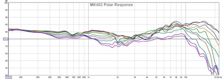

a Polar plot is actually a 3D plot as it displays the amplitude by frequency at different angles. This is critical for applying EQ to a speaker because otherwise you may make the response worse at some angles than others or attempt to EQ stuff like diffraction. You should never take in room measurements at a listening position and apply EQ to that above say 300-500hz, the main reason being that what you have measured is a mix of the direct sound and all the reflected sound along with all the room's comb filtering. What you EQ is captured by a mic that doesn't hear like you hear and so the correction is highly likely to just make things worse. However, if you characterize the speaker in an anechoic like environment, then you remove the effect of the room. If you do this at various radiation angles, you then know what the direct sound, listening window sound, and reflected sound all looks like and can be sure that the EQ you apply doesn't make any of that worse/bad.
Because the data can be tricky to visualize, I am sharing some different examples.
Dayton Audio MK402 Polar graph over 90 degrees. Note that the amplitude window of this graph makes some serious response issues a little hard to see. What is going on between 500hz and 10khz is actually pretty bad. This speaker is pretty good for the money. Add some EQ and its quiet listenable for a very cheap speaker. However, in asbolute terms, it's a very poor measuring speaker with classic dispersion flaws. The rate of change in the response across various angles is different at different frequencies, it isn't constant, so the smoothness of the overall response at different angles is different. That means, for example, that the tonality of the speaker changes as you move your head. Worse, it also means the tonal balance of the room reflections won't match the tonal balance of the direct sound. This is a bad thing, and also happens to be partly why absorbing first reflections can be bad (they don't fully absorb and they absorb selectively, so there is still a reflection, but it's response is far from that of the direct sound).

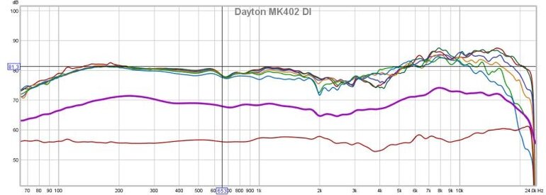

Same speaker visualized differently. Now we are including the directivity index (the ratio of off-axis sound to direct sound. Basically, if it is flat, the response shape doesn't change as radiation angle changes and this is a good thing always. Again, this speaker isn't great, but also isn't terrible. The tweeter beams and there is some weird behavior in the upper end of the midbass.

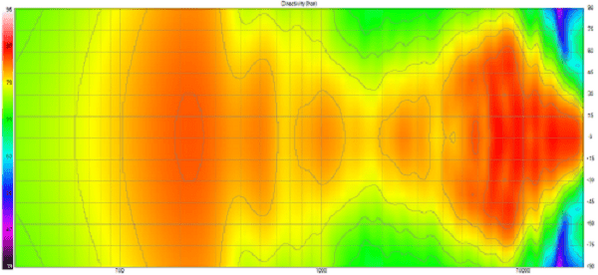

Similar to the above graphs, but for a very good waveguide. What you see in this graph is that the response starts to get rough as you move off-axis. This is caused by reflections in the waveguide along with some diffraction. At 10khz notice a peak that shows up in every response, but gets worse at certain angles. This is probably a cavity resonance or early reflection in the mouth, and as such, is something you could EQ. Notice a big peak at just over 20khz, that is the resonance of the breakup mode in the dome of the CD. That is also constant with angle, so again, you could apply eq to that. Notice that at 2.8khz or so there is a roughness and peak that develops off-axis, but its precise placement actually shifts a little with angle and it gets worse. That is likely a diffraction effect, you can't and shouldn't EQ that. An in room measurement could potentially show that problem and you might attempt to EQ it, but as you can see here, if you did, it would ruin a perfectly good response at most of the other radiation angles.

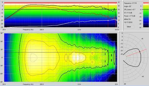

Ok one last method of showing polar data. Because you want to have a lot of polar data and because that becomes near impossible to visualize and read, this approach has become popular. It's more of a graphic than a graph.
This particular approach is too hard to achieve by folks like you and I, Earl Geddes did this using a very specialized scanning approach and a lot of fancy math I largely do not understand. That is less important that the graphic however, looking at this graphic you can see that the color gradation shows a great deal of detail in the response. This makes it a lot easier to see the effect of EQ on the overall response. Any of those circles you see in the response, small areas either directly on axis or paired on either side (that is a 180 degree plot) is something that is not constant across the radiation angle, and so if you applied EQ to fix that, it would cause problems. Make things worse.
