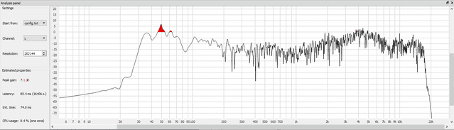

The configuration editor of EqualizerAPO should look like this:
If it's not the case, for example if the frequency response is overclipping by more than 30dB or is more smooth or is looking like a comb filter, than it is likely that the soundcard output is not configured with the appropriate number of speakers and/or the appropriate sampling rate. Verify the soundcard output settings, then try to deactivate/reactivate the output, and eventually exit and open again the configuration editor of EqualizerAPO.
