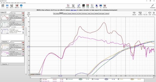

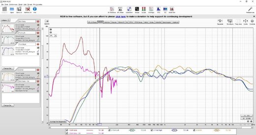

I'm having issues with integrating my subs/mains using a minidsp 2x4HD and Anthem AVM 70.
My front three speakers are MK Sound IW950 and I have two 12" BK subs behind my MLP/sofa.
I've been using a crossover of 110hz for the front three as that's where I can smoothly integrate the subs with EQ. I have issues with dialogue clarity as well especially with quieter moments of speech of muffled male voices. MK Sound suggest the speakers work effectively to 80hz but my sweeps suggest they aren't outputting enough for me to use that setting.
I would appreciated some feedback if its obvious from the graphs on where I am going wrong. I've also attached my REW file if that helps. I applied psychoacoustic smoothing to the front three graphs as advised in a recent youtube video I watched.
