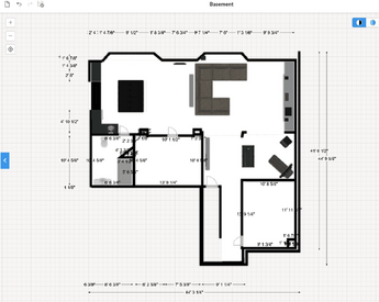

Finally ran my first REW measurements in my HT this afternoon but I'm not really sure what I'm seeing here.
I've attached a rough basement layout for context. The room clearly has a large opening on the right side which can't be closed off. I'm running an older Denon S950H receiver with Audeyssey, so I have some room to tweak if needed.
Any input would be greatly appreciated.

In an asymmetrical layout I would expect there to be an asymmetrical response... Might be interesting to see what a Maxwell's raytracing room simulator thinks about this... :ponder:
True, but I suspect there's more going on here than asymmetry. Without knowing more about how these measurements were taken, all bets are off on a rational interpretation of the data. :)

Yeah. I know. Current listening environment is a loft space in a rental home. The back half of the right wall opens to the floor below. If we were staying here, I'd cover the walls of that staircase with acoustic panels to kill the echo. IIRC, RT60 shoots up to over 4 seconds at high frequencies because of that area.
I would want to add diffusion to the ceiling also. I have the panels, but I don't want to have to repair the ceiling to get our deposit back. Hoping I can do more with the room once we find the house we want to buy. :)
