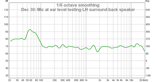

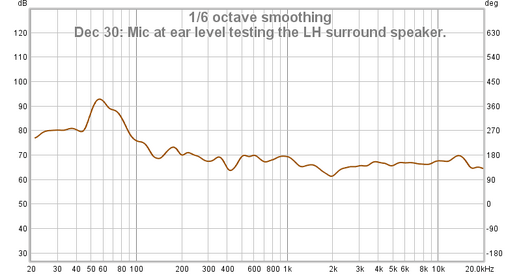

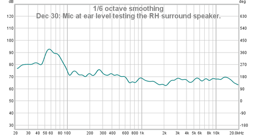

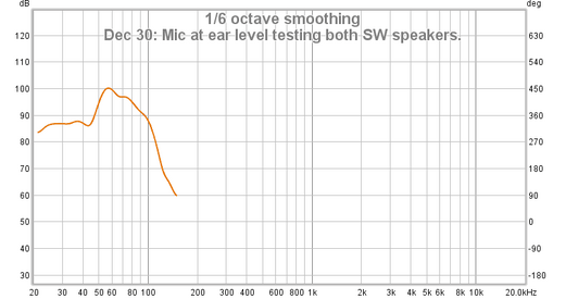

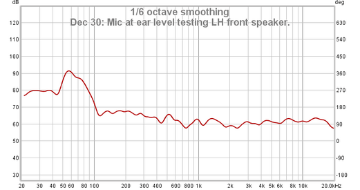

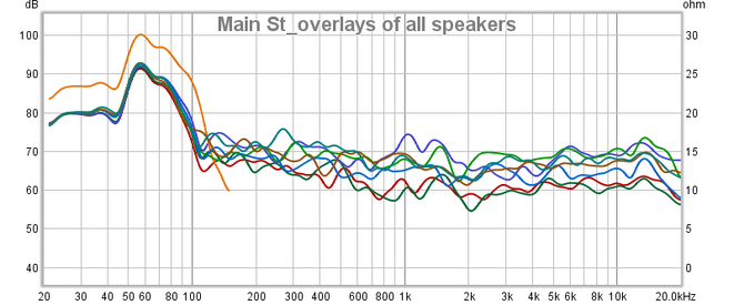

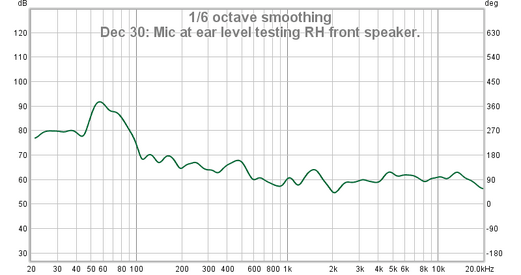

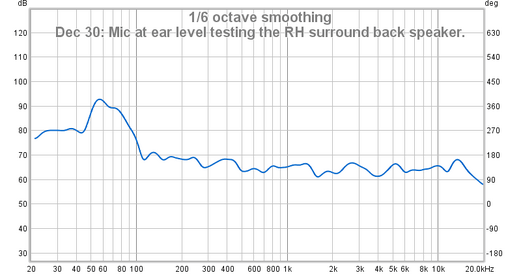

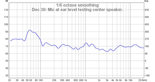

This is my first post in the forum. I have been playing around with the Umik-1 and the REW software. I calibrated my REW according to the instructions for using MS Win-10. I've watched a couple YouTube videos as well. I'm not going lie this is very confusing to a beginner. I saved my latest measurements and captured pictures as you can see here. If you need the actual file how do send it? How do you analyze these graphs? Are these good, bad or horrible? I will take more measurements once I know what I'm looking at. Thank you!

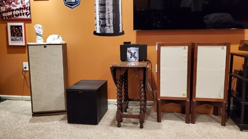

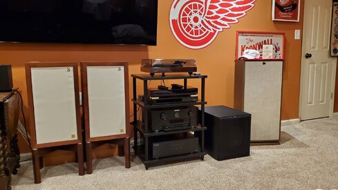

These pictures are from my main seat where the measurements were taken. Left and right fronts are Klipsch Forte III's and Acoustic Research AR-3's make up the center channel.
Distances:
LF & RF = 9.9'
C = 8.4'
LSW = 8.3'
RSW = 8.5
LS = 10.7'
RS = 12.0'
LSB = 7.1'
RSB = 7.6'

8,174
Measurements look fine. The sub level seems rather high and it appears to be active during the tests of all the other channels, so difficult to see what they contribute themselves at the low end.
By looking fine are they okay? Do they need adjusting? When I installed Asio4All I was shown 8 speaker choices for 7.1 surround. The both subs turn on when #04 is selected and are measure simultaneously. How do I measure one sub at a time. Do I have to turn off or unplug one sub while measuring the other? What should their contributions be at the low end? How do you measure just the subs? Thanks!
