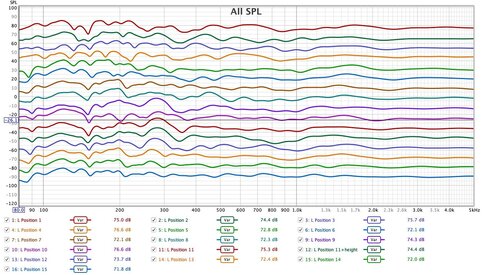

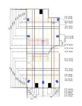

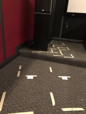

This weekend I embarked on the search of that perfect spot for the front speakers. I wanted to take a scientific approach this time around. Starting with a room simulation model to estimate all the nodes and then using it to find a spot that worked the best. I took measurements from 15 different spots, marking each spot with masking tape. Once I find the right spot length and width wise, I will start changing the hight of the speaker to find the elusive perfect spot. Once I find the right height, I will tilt the speakers to aim directly at the main listening position. Now I wish I had done that before building the speaker stands.. oh well.. live and learn :)
The REW graph I have below has been scaled to show all the measurements in one image. It is not how I am evaluating them ;) The one on the top is where I had the front left speaker the past few days. The last one is the current best location.

Here's the thing with the response... you can fix that with ARC in your Anthem. What you can't fix with ARC is soundstage, imaging and depth acuity. You can't measure those characteristics. You have to listen for them. You can improve on them with ARC once you find the sweet spot.
I would start with looking at the recommendations that Cardas shows for a rectangular room: http://www.cardas.com/room_setup_main.php
You can move the speakers around a little... maybe a foot or so in any direction, and experiment with toe-in to get the best sound stage and imaging. Once you got what sounds pretty good... then start working on the response with ARC. You'll likely only need to fix the lower-end.

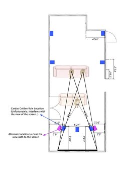

Well... mine is a mixed use setup that needs to work for both watching video and listening to music. I looked at Cardas' recommendations (thanks for sharing) but they will not work for me. He suggested keeping the speakers 4 feet from the side walls ... that will block the screen in my case.
The approach I am taking, is to address as many issues I can thru placement adjustments, absorption and diffusion. Then address whatever remains with DSP.

As usual you were right... (note to self.. stop second guessing @Sonnie :wink: ). I did find locations for the speakers where they had really good response but the imaging went out of the window. So, back to the drawing board. Going to follow Cardas' golden triangle based placement. Will have to move it around a little bit and maybe lower the speakers a little bit to keep them from interfering with the view of the screen.
Stay tuned as the search continues :)
lol... wish I could take credit for inventing speaker placement... but we'll contribute that to Cardas and all the guys that have been in my listening room with fifty-eleven different speakers over the years... particularly golden eared Wayne and Dennis who just keep coming back and back (thankfully).
I think you might actually like that the speakers are a little wider... maybe toe them in a little more... and you'll be slightly forward/inside of the triangle. That's how mine are right now, and I love the presentation.
