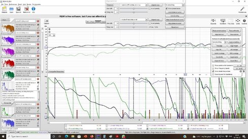

I have a miniDSP 4x10HD controlling my 3way active xover system. Lately I have added a sub. The sub is between the speakers aprox in the middle and 38cm behind them. The distance from the sub to the MLP is 382cm and from each speaker is 380. I wanted to use the alignment tool mach phase. Here is what I did:
1. measured each speaker and sub
2. did trace arithmetic on left and right speaker
3. used the result to align the sub at cursor, 80hz my xover point.
For some reason I get an error that the delay is above 70ms. Considering the distances described this is strange. I tried aligning speakers to sub and sub to speakers always an error. Attached are my measurements. Would love to understand what am I doing wrong.

Move the cursor to about 50 Hz, i.e., more in the middle of XO range. I timed the sub manually and got -50 ms using the current sub polarity and -41.5 ms using the sub polarity inverted. The exact position of cursor can make a big difference when the room effects are large. Using the alignment tool 'align phase slopes at the cursor' I got results close to these values.

It appears the alignment tool limits itself to a 50 ms range so a manual adjustment to the sub impulse must be made if the sub starting position is beyond that. It's a good idea to recheck the timing after any significant PEQ is applied.
I don't know why the needed delay is so negative when the distances suggest the delay should be closer to 0 ms. Is it a wireless sub?
There is a big difference in the Left and Right channel woofer levels, maybe 5 or 6 dB.
50097
I am not sure why you truncated the woofer at 100 Hz. It's best to use full range sweeps on all drivers when all XO's are active.

Thanks @jtalden for taking the time to go over the measurements. The sub is and 18" PA sub. I have truncated the sub at 100hz because I didn't want to run it to areas well outside the xover range. Anyway the huge delay doesn't make sense. In the 4x10HD the maximum delay you can apply is 9ms. When I get longer cables I will try different positions maybe that will help.

After step 3 I could get the alignment tool to suggest 6.14ms delay to the A+B trace arithmetic. A I am using a 4x10HD each driver has its own channel. I dialed the delay to each channel. For some reason it didn't make much different to the measurement after adding the delay. I can say that the base sounds better.

The measurements posted don't reflect the 6.14 ms delay change. The overlay impulse chart shows almost no change in sub timing. Did you remeasure both subs and mains after the change? That is necessary if the mains delay was changed.
Increasing the mains delay is the same as reducing the sub delay. We wanted to reduce the sub delay by ~40 ms, but the largest reduction in sub delay is with the mains at the 9 ms maximum delay and the sub at 0 ms. You could measure both mains and sub using those settings to see how far we still are from a favorable timing.
