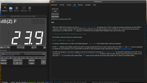

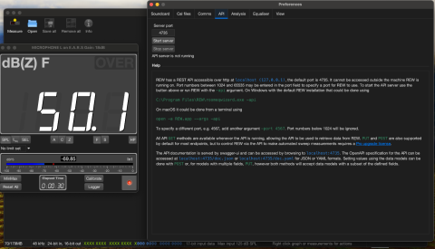

I've upgraded to the latest beta version (on a Mac BTW) but with the same result. Just starting the API server I see the dB SLP measure drop with 24 dB SPL. But 24dB SPL is exactly the EARS and UMIK-1 gain at maximum volume. Could it be possible that this value is not taken into account when using the API?
Here are screenshots and a recording.

Thanks, bizarre stuff. Your EARS unit is from a later build than the one I have and has a different gain curve. REW checks for that using the serial number, but the format of the serial number entry in the EARS cal files differs from the format in the UMIK cal files, so that detection probably isn't working. That doesn't explain why starting the API server has any effect, however. I'll see if I can work out what is going on, and fix the serial number detection.

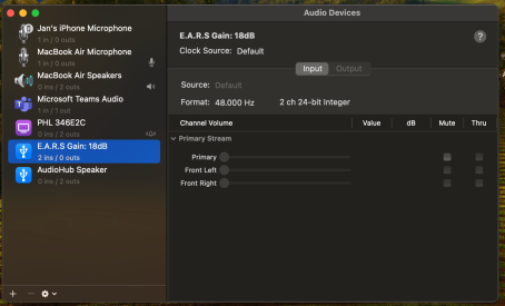

Can you attach a screenshot of the Audio Midi Setup entry for your EARS unit showing the volume controls, please?
