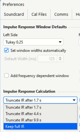

Hey guy,
If you think it has something to do with the impulse response cut, then look at the picture and try it.
Note that the computation time will be longer.
That's where my expertise ends.

Hey guy,
Oh, that's to easy, sorry that I didn't check! Thank you so much already. But do you know, if I need to provide the truncate setting before measurement, if can I also do it after measurement, because maybe REW stored the whole thing somewhere?
