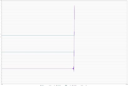

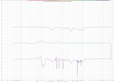

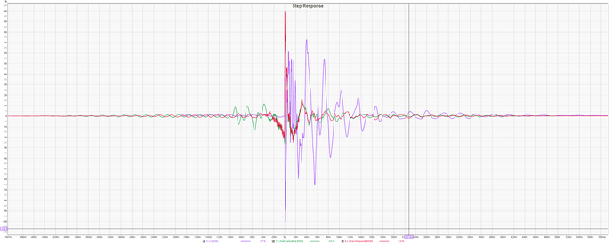

The bottom response in purple is the vector multiplication (A * B trace arithmetic) of the top two responses and creates that odd peak at 24,000 Hz. The original sweep was 0 to 24kHz so I'm guessing it's some sort of an overflow error due to end of data there. I cannot find a way to get rid of it.
I have tried:
* trimming an impulse response is not possible (you can export it trimmed as measurement but lose impulse property when you import back)
* tried a notch filter but EQ goes only up to 22kHz
* some HF tail manipulation is possible but only with a minimum/excess phase copy
* tried merging it with various flat target response shapes (blended or not)
Your help (or anyone else's with some info) is much appreciated.

L0 is smoothed, FD windowed actual measurement (L). "Filters L0" is measurement generated from L0's EQ filters. L0-EP is excess phase of L0. The problematic multiplication "L_Correction" is the result of "Filters L0" x "Inverted L0-EP"

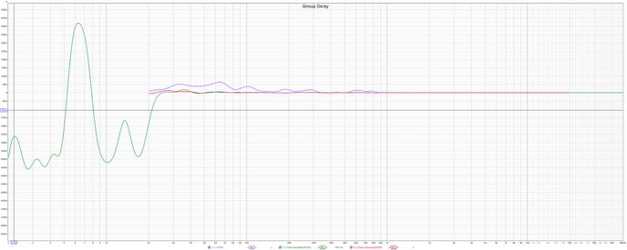

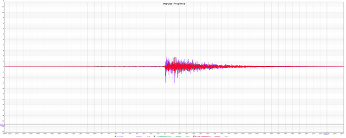

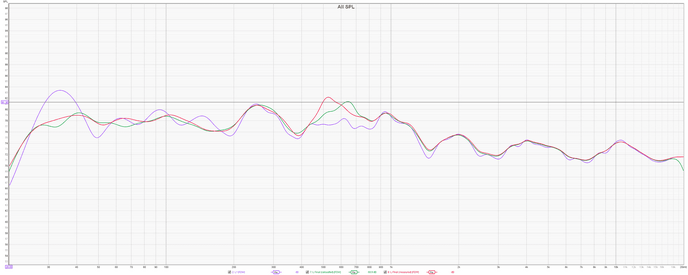

You are right as always. I repeated the whole process for Left speaker with rectangular windows, FDW, smoothing, replicated data etc. There are glitches in the curve even in the 20-200 Hz area although the PA smoothed final results look almost identical throughout. So even if we could produce a trimmed EP (and we cannot) the method is flawed. It's a pity though because sound really improves in actual listening. Look at the impulse, GD and step graphs, all far superior to the original. I could never achieve that (first step peak higher than the original for instance) with EQ + phase equalization.

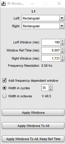

Full span rectangular windows are only needed for the results of excess phase generation, inversion or (depending on the divisor characteristics) division. The test build I sent already takes care of applying such windows where needed and produces cleaner excess phase responses, but regularised division is much less sensitive.
