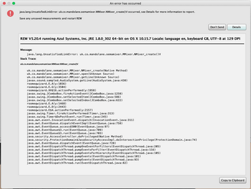

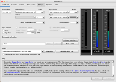

Hi There, I have a 2012 Macbook Pro running OS X 10.15.7, MOTU Ultralite Hybrid MK3 interface and a calibrated Sonarworks Xref 20 mic. I'm having problems getting set up with REW. When I open REW 5.20.4 I get a java error message, attached below. In preferences I can select the MOTU as an input device and once SPL meter is enabled I see level coming through from the mic on input 1, but I can't get any output. I can select the MOTU but the Output field is greyed out. I checked the Library/Java/Extensions folder and there aren't any mando files, the only file in there is MRJToolkit.jar. I also read that firewire is an issue so I am using USB to connect the MOTU to the Macbook Pro. I have deleted preferences and opened REW again, unisnstalled REW and installed again but with the same issue. I also removed the MOTU and tried a test just with internal mic and line out but I still had output issues. Hoping someone can help as I'd love to use REW to help test my home studio, thanks!

Did you check the user and system library folders? Something is trying to access the Mandolane classes.

Many thanks John - I had only checked one location, I checked the other and two Mandolane files were in there, removed these and now REW can fully see my MOTU. Much appreciated!
