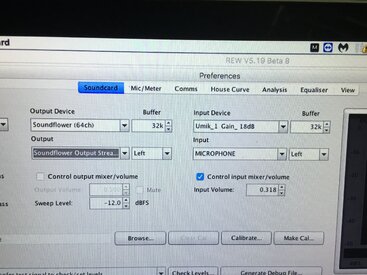

I have followed the guide and have even found the new soundflower 2.0b2.dmg for El Cap but in setting up Rew preferences the guide looks different when selecting the i puts and outputs. Is there an updated guide? And also the Umik-1 guide on the MIDIDSP site show selecting the soundflower app an assigning the HDMI channel and selecting the channel layout but the new soundflower 2.0b2.dmg just installs and no longer has a flower in the menu bar to select set the hdmi and channels. I’ve attached a pic of the preferences panel any help would be appreciated.

Soundflower is not required, select the HDMI output directly. There is more in the help covering how to set up for multichannel measurement on OS X.

Thanks John so I should just uninstall soundflower and make sure I have the latest Java?

Also I’m running bootcamp on the same machine with Win7 to run ARC for my AVM60 and would like to set up REW on the windows side. Is ASIO4ALLv2 still the driver?
7,844
No need for soundflower, REW for OS X has its own Java Virtual Machine so don't need to install Java either. Not sure whether ASIO4All has had an update but it is still widely used.

Thanks John I’ve got a lightning - hdmi cable ordered so won’t be able to select to select the channels till I get it, but everything looks good for now!

Thanks John both are working now. Windows I had to select the asio4all panel and select the hdmi output.
