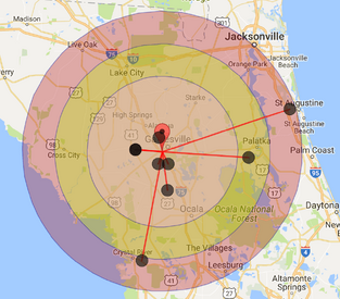

I have about as bad a direction problem as possible. I can get a few local signals with omnis, but three times as many with a better directional antenna. I am just looking to see if there are any recent options that I have missed. Even marginal improvement can get a few more channels here.
L
Leonard Caillouet
Guest
One of the best mapping tools is at Antennas Direct. It has a lousy listing of the stations but I like the map offering. This is my situation.

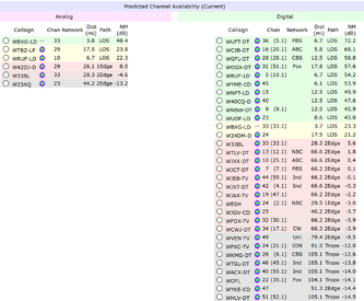

If you want a good list of channels that might be available to you I prefer the list format at receptionmaps.com.
