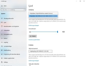

Did some troubleshooting below. Maybe you can understand what is wrong from that. Or if you want me to test something else?

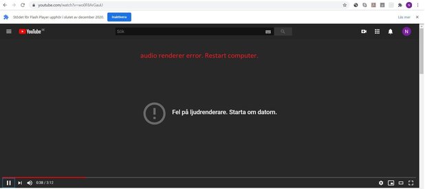

Test 2: start REW (REW_windows-x64_5_20_beta_55), new installed. Play YouTube but no sound. NOK (audio renderer error. restart computer)
-> exit REW and reload YouTube page. OK

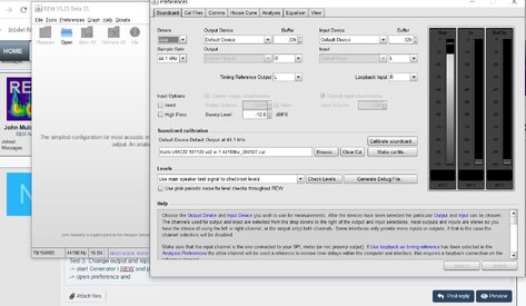

-> open REW and check preference.

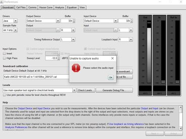

Test 3: Change output and input to Default device. Close preference. Play Youtube. OK
-> start Generator i REW and play. OK
-> open preference and Check Levels. NOK (please select audio input)

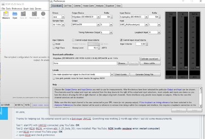

-> quit REW and open it again. Check Levels. Process starts and mic ins recording but no sound. NOK
-> Start Generator but no sound. NOK
-> Start YouTube but not working. NOK (audio renderer error. restart computer)
-> quit REW and reload YouTube and not sound goes to receiver again. OK

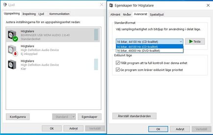

  • In the Advanced audio properties for the device input and output (open Sound Control Panel under Related Settings on right hand side of Sound settings, selected device, click Properties, go to Advanced tab) are the devices set to allow applications to take exclusive control? If so, try unticking that.
  • Does the default format sample rate on the Advanced tab match the rate you want to use in REW?
Thanks, I got it to work again. Changed the chosen sample rate in sound card setting from 48 to 44.1 and now it works.
Many thanks.
