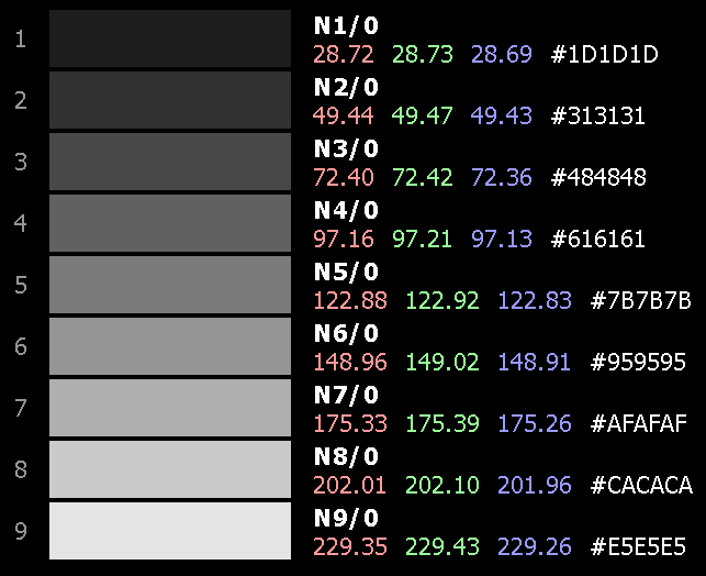

Paint - Paint is by far the easiest and most affordable way to a projector screen. Over the years there have been numerous formulations and discussions regarding paint for a screen. Everything from polyurethanes, micas, aluminum and more have been added to paint in order to get more boost for projectors back in the day - including the discovery (by myself and others at the old forum) of Black Widow which was, and probably still is, the most popular and used worldwide paint mix. It is my belief that the days of crazy formulas for screens are numbered, if not already over. With the advent of HDR, projectors willing to stay relevant have had to increase their brightness to fall within the specs of the new standards. Even before HDR, a lot of companies were slowing ramping up the brightness - case in point, my Epson Powerlite 3010 was delivering 23fL on my 100" screen on a new bulb and I measured around 17fL over halfway through the bulb's life. So before I keep rambling, suffice it to say that "special formulas" for newer projectors should not be considered.
So, where does that leave us with paint? Simple - Neutral Grays! From plain old white all the way down to a N5, you can find an off the shelf tint at Home Depot, Menards, Lowes, Sherwinn Williams, Benjamin Moore, etc. that will suit your needs. Neutral grays are based upon the Munsell system:
It would be worth mentioning that there are always several commercial paint options available on the market such as Goo Systems. Suffice it to say that I have measured, compared and reviewed many of these paints over the years and I have never found one that beats OTS (Off The Shelf) neutral grays. Sometimes they will come close to matching the performance of a neutral gray, but it's usually at a cost of 3X as much. Friends don't let friends do Goo!!
Paint finishes vary by manufacturer. All paints come in a flat finish, it's what comes afterwards that varies. Some manufacturers use eggshell, some use matte. Regardless, it's best to stick to a finish that is either flat or one finish up from flat - matte or eggshell. Anything higher will more than likely introduce issues such as hot spotting, artifacts, etc.
Laminates - My second screen was a laminate based upon Wilsonart Fashion Gray which was a very close N8. There was also a wonderful white laminate called Designer White. Limitations to these types of screen were size, potential hot spotting and ease of build. IIRC, the sheets were limited to five foot width, some people reported hot spotting and they weren't exactly an easy implementation.
Fabrics - Some fabrics that are available to use as a DIY screen include Blackout Cloth and Spandex.
Blackout Cloth (BOC) is the material that is out on the backside of shades or drapes to block out sunlight from entering through. There have been varying degrees of BOC made available at different times. Some have been reported to be more of a tannish color while others have reported being a bit more gray in nature. The majority though have been white and from what I remember, most of the samples I measured came within the N9-9.5 range.
Spandex is anothr material that has been used as a screen for DIYers looking for an AT DIY screen. My good friend Don Terwilliger was doing a lot of work on spandex when he suddenly and most unexpectedly passed away. I never did any work with this type of material so I can offer no opinion one way or the other.
During my time at HTS, I measured thousands of samples of screen materials and paints. Early on I compiled a spreadsheet of the spectro readings from some of those samples. I still have pretty much every screen sample that a manufacturer sent to me and I will be re-doing these readings in the very near future and posting them here.
