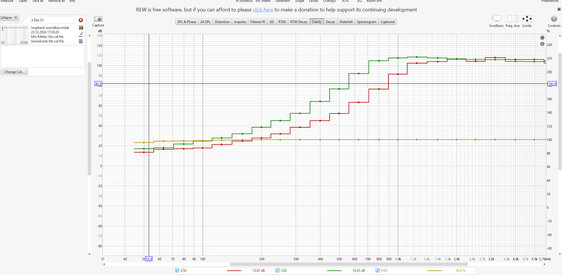

I think there is no feedback, because distortion is very low and FR is very linear. I choose estimate IR and create minimum phase. attach is the mdat file too . maybe a setting is not good or REW problem ?

The RT60 curve is from the octave band filter delay, there are options to reduce it - see the RT60 graph help.

I choose third octave this give more delay in low. I choose time reversed filtering it reduce to 200 ms at 50 hz and then filter order 6 then i get 120 ms. have the time reversed filtering any disadvantages ?. At least good to see that it is not only my room that increased that so much.
is it possible to add for settings a compensation. measure a theoretic perfect signal as reference example displayValue50hz=result50hz - reference50hz. displayValue60hz=result60hz -reference60hz ?.
same maybe work for the phase ?.

or a better idea . is it possible when do a calibrate soundcard that this is the reference and the result of the soundbox loopback is subtract from the measurement automatic ?.
No, the effect of the filters depends on the signal.
No, phase is affected by the position of t=0. Adjust the t=0 position or try estimate IR delay to alter it. Minimum phase generation needs to use suitable low and high frequency tails for best accuracy, but note that DAC reconstruction and anti-alias filters are usually not minimum phase.
