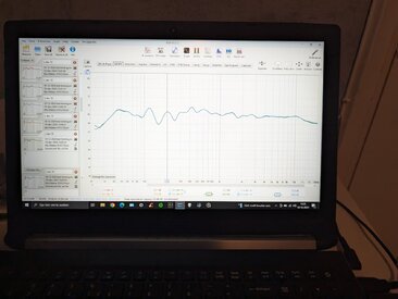

Hello everyone, I'm fiddling with rew and I am excited for it's capabilities, I'm trying to create filters using this method :
but I'm running into problems;

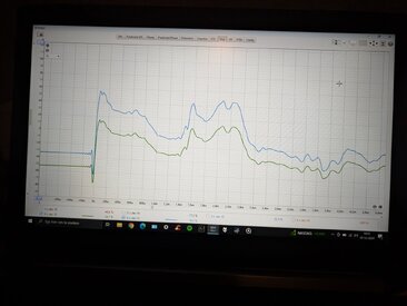

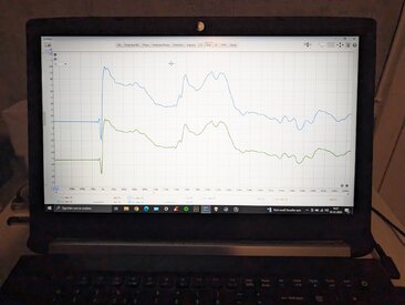

1. My Impulse view doesn't look the same like the one in thee video so it's hard to time align or see anything in Impulse view here's how they look top picture is video bottom is my Impulse
2. For some reason when I'm Creating VBA filter at 18:00 of the video i don't get the same results like in the video due to asymmetrical shape of my bass response between 2 peaks maybe I could create different LP HP filter that could do a better job in my case :

Change the IR display with this control then zoom in on the time
if you use the little camera icon above the REW charts then the legend and x & y axis will be captured for better viewing.
