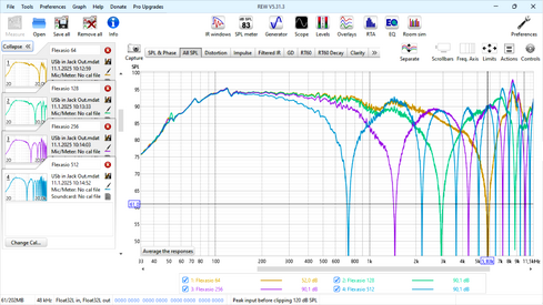

I was making normal acoustic measuments with TBone Microphone and sound "tube" whic is USB connected. The results showed unnatural zeros.
Later I noticed that the location of these dips depends on the sweep length and it happened with both java and Flexasio interface.
I woud like to know has anybody had similar experiences and is there a possible solution
Best wishes HPu
PS
The longer the sweep the less are the zero frequencies
8,218

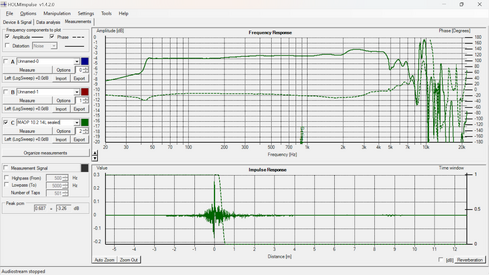

I did not understand your question. I make REW measurment and the resurts are not looking about the same with different sweep lengts. When I listen these zero>SPL frequences (with REW signal generator) there are no difference. It means there is no drop in hearins sensation
Here is a screenshot of HOLMinpulse neasurement. It looks too good, but its about correct the MAOP10 had a F0 39Hz. Closett box quite a lot of filling

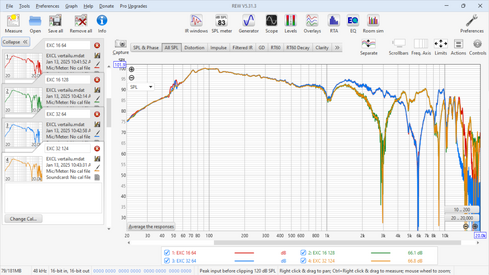

I have noticed the EXCL devices but paid no attention. In the picture are four measuments with these devices. the first number is the device buffer length from preferences. (with bigger thar 128 REW goes crazy)
and the second number is sweep lebgth
the low freq measusements are consistent maybe up to 2kHz. (the 1kHz dip is not infinity and migth be real)

phofman
Jun 26, 2019
197
I would recommend to keep using wasapi exclusive (EXCL), to eliminate the potential issue with duplex ASIO to two different audio devices.

Use the EXCL devices, buffer length 16k for input and output, then make measurements with the output looped back to the input. Use the same input channel you use with the mic. That will show whether there are any issues with the interface settings.

Hi
It is not easy to get a loop with tbone microphone. BUT no problem
the 16k buffers and EXCL devices corrected the issue.
Results of sweeps of different lengths are very same. no extra dips etc
Thank you all for help.
