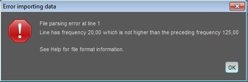

I have just upgraded REW from version 5.19 to 5.20.9. I am using Jazzi'z Tuning Companion for REW to create curve files for my car audio.
I have now a curve file that I can use in version 5.19 but I get an error message in the newer version of REW. I have tried to create the same file again from scratch but it will still not work in 5.20.9.
Any suggestions why this problem occurs?

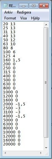

Please attach the file. I guess the issue will be that only a few lines in the file have a comma decimal delimiter and the others have none, so REW may be incorrectly identifying the decimal delimiter.
Here are the all examples that I work with at the moment.
Thanks. Change the first line in that file to
20 13,0
and all should be OK. REW wasn't dealing properly with finding a comma further into the file, I have fixed it for the next build.
