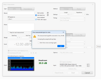

I am using rew with widnwos 10 hdmi out to denon avr with umik-1. What do i do to this error? I already cranked up denon till 75 but still spl metre was not reaching 75 db

atleast i ran finally. but it gave these errors in between now.

Both are warnings rather than errors. Measurement distortion may be high because the measurement spans a range where the source has little output (for example, well below the low frequency limits for a speaker or well above the low pass frequency for a sub) or because the measurement levels are too high. You can look at the distortion levels on the Distortion graph to see which might be applicable.
plz help me what do i do in windows 10 so that both these dont appear?
