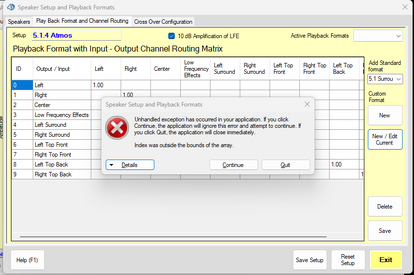

When creating a new speaker layout, selecting the "new/edit" options (and other potentlal options) generates unhandled exceptions.
For example.
1) Create a new speaker setup.
2) Add a standard format
3) Select New/ Edit option
4) Result is a unandled exception
All I need do is move around between adding "new" speakers, changing tabs, and it's almost impossible to avoid these unhandled exceptions.
@juicehifi Bernt you really need to take a look at this, and play around in these menu options / changing tabs. I've had these issues with each release since Atmos functionality was added.

Interesting that you didn't have issues. I'm sending you separate e-mail with link to video on one-drive (to big for e-mail) demonstrating exception.
For this video, I deleted my al.ini and started from scratch with a 5.1.4 setup to demonstrate. However, there seem to be other ways to create these unhandled exceptions.
Hopefully if you can recreate it will all end up being related to a common issue.
And to answer your question about "Was it customized", I guess this seems to be the main trigger for getting an unhandled exception, which is what I guess I do in the video link I provided.
Yes, there’s a problem with customizing the Atmos formats. I’ll try to get the fix out in a few days.
