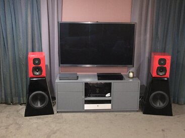

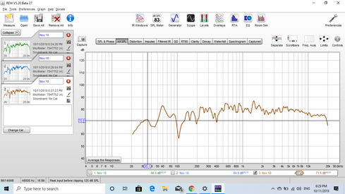

I have taken my first measurements of my PHL/Focal bass reflex stand mount speakers so I can work out were to cross them with there 12" Rythmik Audio servo subs.
I was hopping to get some advise on were to cross them.

The measurement is of both left and right bookshelf speakers

Best posting an mdat file with measurements of each speaker on its own and each sub on its own.
