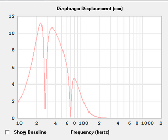

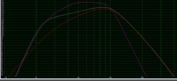

Take an 18” driver with 2000 watts rms power handling and 15mm xmax. This would be a very high performance pro subwoofer but those specs might seem modest at best compared to an HT driver. Now imagine that it’s got a RE of 2ohms, a BL or 32, and xmech of 60mm. It’s sensitivity is 99db (but not at the low frequencies for which it will be used). If we stick this driver in a modest/large ported box and tune it to 20hz it may actually come very close to the maximum output of a typical 18” HT driver. However it may be limited below 35hz by exceeding its linear excursion. While it may need less power for a given output and have lower distortion in that range, it would probably fall short by a factor of 2-4 of those HT subwoofers at 35hz and below (3-6db). Some say, well that’s the trade off. You can have loud and low distortion low bass or loud and low distortion upper bass, but hard to get both.

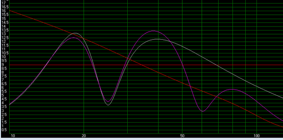

here comes the ABC box. Now with a ported box of typical construction a minimum motion notch would exist centered at the tuning frequency. Tuned to 20hz it wouldn’t provide much of any support in controlling excursion at 35-40hz and yet the driver may very well be exceeding xmax by that frequency. Now imagine two minimum motion notches centered at the same 20hz and at 30hz (or maybe 35hz). Now you have the exact same response shape as before, but you can gain significant output before exceeding xmax.
The Keele rule for these boxes is that volume is taken as the normal volume for the bass reflex you intend to design. You then divide it in 3rds. You then make the driver chamber 2/3 total, and the second chamber. Port as mentioned previously. Port dimensions are all identical but obviously port tunings are not.
So you can use very efficient and very linear bass drivers in very high performance subwoofers and gain additional headroom in the low frequencies allowing you to tune often a full octave lower while maintaining good excursion control.
When I have time I’ll try to post models comparing a common driver in these two boxes to show what happens. You will have to use your imagination a little bit as Hornresp doesn’t represent reality correctly. The internal port is represented as nothing more than a minimum motion notch in the response with no port contribution. I think it’s a mistake but not being as smart as Marten King, maybe just a limitation of such a modeling approach. None the less these have been built and measured by Keele and others (they became popular in car audio too) and do work as advertised.
