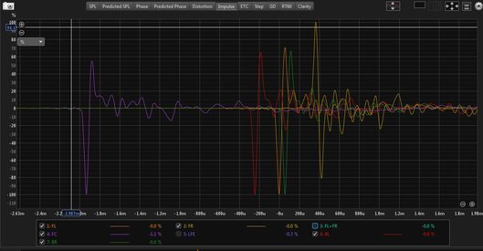

1 - For given speaker, the delay is not constant. It changes constantly from -2 ms to 6 ms. Why is that?
2 - Let's suppose I have the following results on measurements at the MLP
FL: -0.025 ms
FR: 0.34
FC: -1.96
FLE: 1.99
BL: -0.26
BR: 0.03
How would you apply those delays to CamillaDSP? I tried entering them as they are and got a ' Invalid filter 'delay_l'. Reason: Delay cannot be negative' error, e.g.

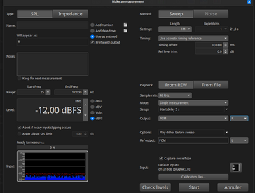

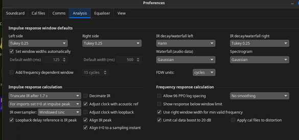

Not sure.. are you using a usb mic? on the analysis preferences tab is the box checked for:
The Adjust clock with acoustic ref selection controls whether REW compensates for clock rate differences between input and output when using the acoustic timing reference. If this option is selected an additional timing reference signal is played at at the end of the sweep and the time between the timing reference signals is used to calculate any clock adjustment required to match the input and output device clock rates.

I haven’t used Camilla, but to get rid of the negatives make FC 0 and add 1.96 to every other speaker’s delay.
Yes, UMIK-1.
Oh thanks, will try that and let you know.
Here's the result. The LFE is probably not meaningful but the other delays make some sense. The FC is the closest to the MLP. Is that all there is to do? First generate the convolution filters, then apply the delays given by the measurements to the DSP. Simple as that?

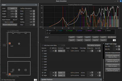

Oh I understand the point.
You presumed the farthest speaker would be FC, it's not the case. In fact the main and surround speakers are 2 meters to MLP plus or minus 30cm whereas the FC and LFE are at 1m50 and 1m60 respectively. Therefore the farthest speaker whould be FR, by 5 cms and my numbers are probably closer to reality by a hair. Thanks a lot for the clarification. Mucho apprecietado.
I didn't take LFE into account because its reported delay (1.9916) doesn't make any sense. I mean 2 ft is correct, but in the wrong direction. That's why I didn't add any delay (yet) to the LFE, not knowing how to deal with it, I ignored it for the time being.
Here's the room simulation with the proper distances.

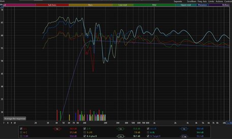

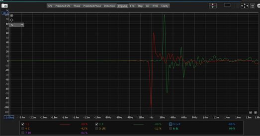

I took a look at the front left/right. Something is clearly going on.
This screenshot is using the alignment tool.
1/6 smoothing has been applied to improve visibility.
Red/Green are front left and right. In a perfect world when summed, the sum will be 6dB higher than the individuals (assuming they were 100% identical to begin with, but you get the idea) This Sum is represented by the top dotted black line.
The Blue line is what was obtained when the speakers were measured together. Its below the separate measurements from 100Hz to 270 Hz and well below the perfect world possible summation (dotted black line). The phase traces on the lower trace show the reason.
The solid black line the mirrors your R/L (Blue) measurement is REW's calculation of the sum of the two taking phase into consideration.
The below chart shows:
Purple - A+B (best possible)
Black - Right + Left measurement
Green - Right + Left measurement with Right inverted polarity.
There's definitely some kind of phase issue going on and it doesn't look like reversing the speaker wires will resolve it.
Best guess is the sub interacting differently with the right vs the left. Swapping the left and right speakers and re-measuring would prove or dis-prove.

Assuming a root cause for the FR phase shift can’t be corrected by other means, you could perhaps use an AllPass filter in Camilla DSP to correct the FR phase in the problem region, to some extent. I’m not familiar with Camilla, so I can’t help with how it's input, or if one can do it with the current filters also engaged.
There’s also a free tool called RePhase that I’m pretty sure would do it. It's should do a more exacting job than all pass filters. I wouldn’t be able to help here either, unfortunately.
An 2nd order all pass filter applies a 180deg phase shift (therefore inversion) at its center frequency and slopes to 0deg phase shift at either end. It does this without changing the frequency response.
Here is the effect of an all pass filter applied to the FR measurement from the .mdat supplied earlier.
Specifically 2nd order (which I'm guessing is camilla default) centered at 400Hz with a Q of 1.41 which equals a bandwidth of 1 octave, so in this case 200Hz to 800Hz.
Purple Line is FR + FL without regard to phase.
Green is the FR/FL together measurement
Blue has the AllPass filter applied to the FR speaker and then the FL and FR are calculated with phase taken into account.

Eyeballing the resulting response you could try an AllPass centered at 240Hz and a Q of 4.5. It's not going to be optimized because of eyeballing from the chart, but you'll be able to listen to and measure the results. Be curious if the FR impulse response is corrected with the allpass applied, too.

Amazing. Thanks so much. Food for thought. In the meantime, I'm attaching measurements with the L and R speakers swapped. In other words, the L curve is generated by the R speaker and vice-versa.
