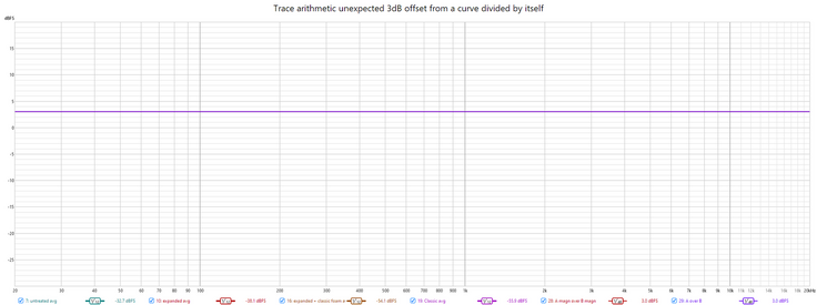

Team,
Using REW 5.31.3, the division trace arithmetic is 3dB different from what I expect. For example, here is a measured curve (from the RTA) divided by itself. Rather than a flat line at 0dB, it is flat at 3dB for both A/B and |A| / |B|. Did I miss a setting?
Clayton Williamson
May 25, 2017
21
Ahh, thanks!
Dang, I tried dBFS, dBV, and dBV, but didn't think to try dBSPL. That's odd to me though, since the measurements were made in dBFS. Why does x dBFS / x dBFS not equal 0dBFS?
greatadrian
Sep 4, 2017
23
Preferences -> View -> Full scale sine rms is 0 dBFS (untick it). (I hate this stupid AES convention that full-scale sine wave is 0 dBFS šŸ˜–)
Note that, in dBFS view, for |A| / |B| you gonna see 0 dB across all frequencies. However, for A/B (complex division) it will be -3 dBFS RMS.
