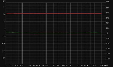

To get back to the ASIO mode: Even though I kept getting the resync request error, I still proceeded with the test process and the graph that I got is included as an attachement. Is it normal to get a 105 SPL signal when the level calibration has shown a 7ish dB difference between the -20dBFS test signal and the Hi-Z input signal? Is this kind of calibration file useful or simply wrong? It does look very linear, which is to be expected, but maybe it's still wrong...

Looks good, though the SPL span is very, very large - most things would look flat on that scale :). No obvious issues though. The SPL figures themselves don't mean much until the SPL reading has been calibrated, but the cal file generates values relative to the level at 1 kHz so the absolute SPL makes no difference to that.

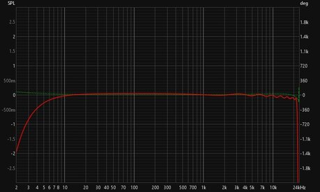

EDIT: I redid the calibration and this is the new measurement that I'm getting.
Is this closer to what it's supposed to look like rather than that 105 SPL flat line that I got from my first calibration attempt?

Yes, looks good. There are two aims for the loopback cal, making sure monitoring is off and accounting for response roll-offs. For acoustic measurements it is rare to find an interface whose roll-offs are significant. For maximum accuracy (e.g. when measuring component electrical responses) the loopback cal should cover the whole measurement chain apart from the system being measured, which is replaced by a cable connection.
