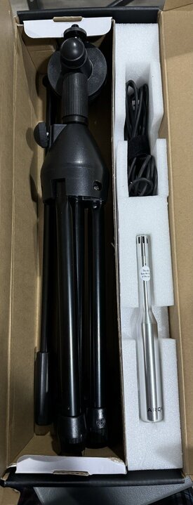

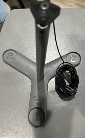

To start with the mics are very different. Not sure if Yamaha has changed their mic, but its a bit flimsy, and odd to use. Anthem includes a very nice tripod as well for the mic. Also Arc allows you to save a file, multiples if you want of your set up. If for some reason your setting get screwed up you can just upload the file and it will load back exactly how you had it. Also handy if you wanted to switch between some different crossover settings. AlsoYamaha was done on screen, Arc is through your PC, Mac, they also have an app where you use your phone, not a fan of that. Arc, also makes you measure from a minimum 5 different points. When I had Yamaha it was only 3. I feel Arc is a great solution to assist with out of the box settings for newbies. Its also pretty advanced if you want to take a deep dive.
