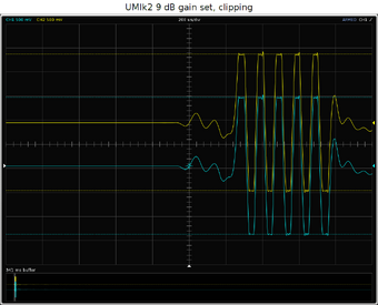

I asked miniDSP about the distortion issue, they said this,
The mic is simply clipping = raise of THD as expected.
UMIK-2 doesn't have a gain switch as the UMIK-1. It's a software controlled gain.
We do have a software that we provide for that application. A simple support ticket and we'll solve the issue. If you know the customer, maybe ask him to reach out to us?
The default gain on the microphone is +18dB so software like REW and Dirac don't ask for high output level level before the speaker (using dBFS scale). That's the reason why the gain is raised.
Always reach out to us via our support portal (support.minidsp.com).
We're always here to help! :-)

I changed the internal gain with the mentioned tool from +18 dB to +9 dB and adjusted the header in the calibration file. With this setting the clipping occurs at rated SPL
Could be worth contacting MiniDSP to see what they say.
