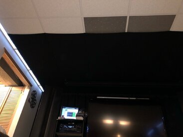

Minor update on the adventure:
The package finally arrived...and it had a roll of white felt, instead of black.
I got a new roll and jumped right in to at least get some proof of concept until I can devote some time to it.
While the magnets I bought are actually strong enough to hold up the felt, I quickly found out that if a few let loose, the cascade effect would bring the whole thing down. This changed my angle of attack a bit.
I ended up using double-sided carpet tape on the ceiling grid pieces that run back-to-front of room to hold the felt, followed by about a hundred 10mm x 3mm magnets 50 neodymium silver, 50 ferrite black). I have another hundred 15x3mm neodymiums on order (they are stronger than ferrite, and going from 10 to 15mm doubles the strength). I plan to cut matte-black covers for all magnets that I can see when the projector is on.
I only did the front six feet of the ceiling, and covered the remaining screen case with some scraps (I had already done the lower screen "frame" tube and the lower front of the case).
I watched a movie, and I have to say that even this minor change had a major impact on the experience. I was now seeing an image "floating" in darkness, and not ceiling tiles, light reflections, the screen case glowing like a fluorescent tube, etc.
I'm really looking forward to doing the rest of the ceiling. Future changes will include darkening the walls (considering theater-red paint or even cloth covering), new TV stand, dark pillow covers for the couch pillows, and something to eliminate the light reflection on the posters (matte "glass" or maybe posters sublimated on cloth if I can find some).

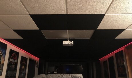

Thanks, guys. I'm back from a trip out of town, and did another six feet yesterday. Will test tonight. Tomorrow night I'll do the final 3 feet and get to see the difference without light bleed from the overhead projector side cooling slots.
Next up will be the wall color and then trying to find movie posters on cloth for less than $300

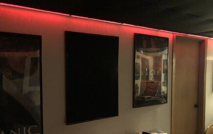

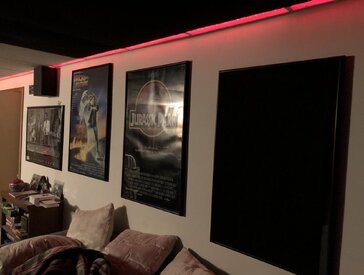

The ceiling is pretty much done.
The poster-on-linen idea is going nowhere fast, so I'm exploring a tangential idea: poster covers.
I don't want to get rid of the posters, because I like the vibe. But the reflections are too much.
Sooooo...I made some covers out of leftover felt to see how it'll look with the projector on.
Gonna test tonight, but having them on in low light already looks promising.
