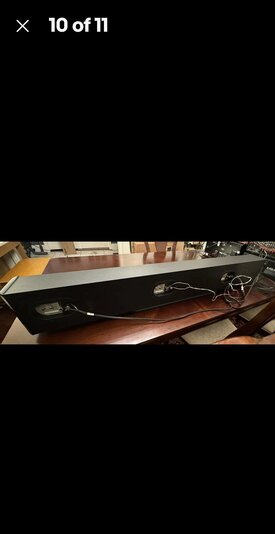

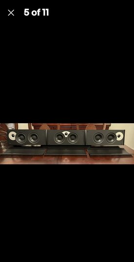

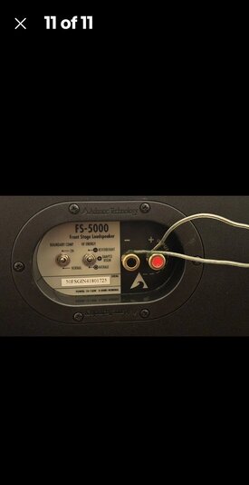

So I stumbled upon a speaker that I feel like would definitely enhance my home theaters LCR but I'm not exactly sure how to make it work or if it's even possible. I feel like there must be a way to do it but would love some input/advice on how to go about it if I decided to go this route and buy the speaker.
I'm currently running all Atlantic Technology speakers with the exception of my 4 subwoofers in my 7.1.4 system from my Denon X3800H. I love the sound I'm getting in my MLP but my seats to the left and right could definitely benefit if my Center channel had a more wider dispersion. I haven't tried to change it out for another speaker mainly because I don't want to loose the great timber I'm getting from it now.
The speaker I found though is a Atlantic Technology LCR all in one and after digging into the specs it should timber match with my current LR. The problem I'm seeing though is how to wire it so that my receiver sees it as just one single center channel. It's has 2 internal dividers that separate it into 3 different enclosures for each channel L-C-R and of course that means 3 separate connection points with their own crossovers and nominal impedance values of 8 ohms each.
I'm all about DIY and I'm completely comfortable with reconfiguring this thing and im sure im capable of doing what needs done to make it work I'm just not sure what's the best way of doing it. Ideally I would want the receiver to see the same impedance it sees with my LR so that it doesn't play louder or quitter correct?
Am I on the right path of thinking or am I way off and trying to do something that's not worth the headache or even possible?
Thanks for any help or input with this
I've attached 3 photos of the speaker I'm talking about possibly doing this with.

Wiring in parallel will decrease the impedance the amp sees, and wiring in series will increase the impedance the amp sees.
I'd be concerned that running your CC signal through three speakers distributed horizontally will upset your imaging at all seating positions.
Which model speakers are you currently using as mains and CC?

I agree with Peter, do you have a AT center now?
AT centers are pretty good and they normally don't suffer from off-axis lobing because of their design

That's a nice setup, the front speakers are matched and should sound good including center channel, even off axis.
I looked over the manual for your speakers and it's recommended to use an 80Hz crossover for those speakers, I'd make sure that is currently set.
There are also switches on the back of the speakers, including the center to adjust the tone of the speaker depending on the acoustics of the room, you might want to try the different settings and see if any of them make any difference.

There are already a lot of great thoughts in this thread geared towards what I agree should be the priority - working more effectively with what you have now.
But if you do get to a point where you feel the need to use this center speaker, I believe the only effective way to run it off an AVR would be to get a 3-channel amp, use the center channel line output and power each section of this center off its own amp channel. Your AVR, however, does not have a line output for the center channel, which brings us back to working more effectively with what you have.
Thanks for the input. The fact that my AVR does not have any pre outs is definitely a large downside to the project. This is why i was leaning more on finding a way to wire all three "LCR" in a way that the AVR is presented with a 8-6 ohm load but so far its looking like a dead end project.
