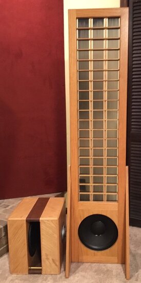

My latest DIY design (Jazzman MkIII):
The drum head resonance: Is simply avoided (not excited) by tensioning the diaphragm to resonate <100Hz, and then crossing the panel out to the woofer at least one octave above the resonance using a steep-sloped digital crossover (250Hz @48db/oct). Hence; the panel is not being energized/excited near the diaphragm's resonance frequency.
Dispersion: Tailoring the dispersion requires choosing either a narrow sweet spot with precise imaging or a wide sweet spot with less precise imaging or something in-between (physics forces this choice-- you can't have it all).
I chose the latter option and tailored the segmentation scheme accordingly.
The stat panel employs symmetrically arrayed 15-segment wire stators driven sequentially from the panel centerline outward to function as a line source projecting a cylindrical wave-front. This works amazingly well; giving wide, smooth-trending dispersion.
Load/Impedance: The RC line which curves the wave front also linearizes the impedance and renders it predominantly resistive, as only the capacitance of the first two wire groups is reflected back to the amp. I wouldn't know this myself; but it was explained to me by a very smart ESL guru that this scheme also reduces the phase rotation of the impedance reflecting back to the amp, which helps keep the amp stable (i.e from going into oscillation).
Woofer/Panel Integration:
The matching dipole radiation patterns of the excellent OB mounted Eminence KappaLite 3012LF woofer and the stat panel merge seamlessly to sound like a single, coherent driver-- the best integration I've heard in a hybrid ESL.
Reliability:
The wood lattice supported wire stators are less impact-tolerant than perf metal stators and must be handled accordingly. Otherwise; they are highly arc resistant resistant and therefore unlikely to be harmed by even crazy-loud volume levels. Even with no protection circuitry, the upgraded electronics interface has also proven to be reliable. Over the past five years I've built seven pairs for myself and audio pals, and all are working fine.
How long will the diaphragm coating last? I can vouch for 5 years so far-- but I'll get back to you on that in about 10 years if I'm blessed to still be here.
My website with build photos & write-ups for the Jazzman MkIII speaker: http://jazzman-esl-page.blogspot.com/?m=0
Jazzman MkIII photo:
