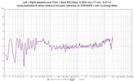

Here are my latest measurements of my system as is without anything in the analog path and the zip contains all the measurments
the smoothing is 1/24

I had a look at the measurements, but there's nothing I can tell from them about the sound.
Have you tried room simulation in REW to see the effects of various speaker and sub positions? Unfortunately, REW doesn't handle asymmetric room shapes.
