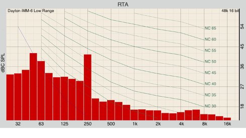

Taken at the return in my bedroom. The fan noise in this room centers on 240hz (250 but ignore that, it’s the 1/3 octave binning).

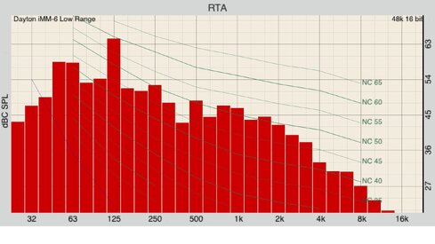

Theater room at supply. Note the same fan noise peak. The effect of my treatment is obvious but also not obviously perfect. Also note the bedroom is as far from the hvac as possible. The theater is right next to it and the duct is far closer and more direct.

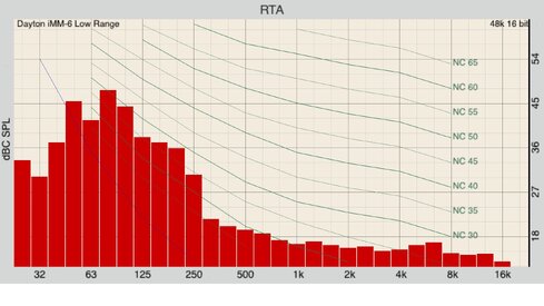

This is inside the return duct of the theater. Don’t look at relative volume. I wanted to show that the 120hz and 240hz wasn’t present.

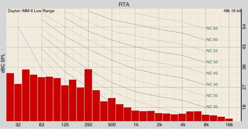

Inside the HVAC equipment room. Note the fan noise peak. It’s 120hz and as such the 240hz was a harmonic or that (I know it shows 125 and 250, but an FFT spectral analysis gave more precise info. Also, makes more sense for the hum to match a product of 60hz since the fan is synchronous.
So you can see what I did clearly effected the duct noise over other spaces, but a lot of LF garbage still gets through from the HVAC. As for sound transmission through the duct, much harder to test. I’ll try later. Maybe I can place a speaker into the duct and then measure at the supply and return inside the theater vs just outside. It’s a similar distance from the source then.
