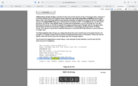

Hey,
does somebody know why the Log interval is so weird? See Screenshot from Help Data attached. And can it be changed somehow?
Best
7,444
The update interval for the SPL meter is linked to the blocks of data it analyses, 8k samples at 44.1 kHz and 48 kHz sample rates. It analyses blocks of data so that the calibration file frequency response corrections can be applied. At 44.1 kHz that gives the interval shown in the help. It can't be changed.
