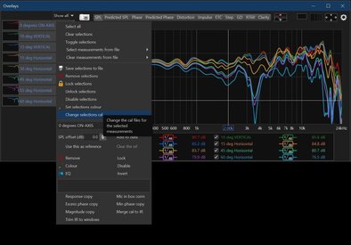

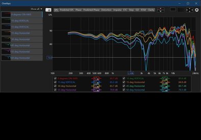

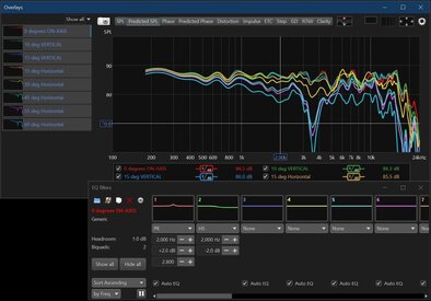

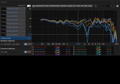

I have a suggestion: include a "change selections EQ" option so that one can apply PEQs across multiple measurements simultaneously instead of doing it manually individually or (slightly more efficiently) loading a saved preset one-by-one. It's should be no more similar with the new ability to change calibration profiles across multiple selected measurements...
