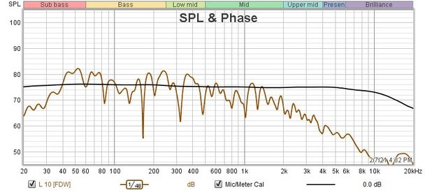

I am newer to the forum and attempting my first calibration with my home theater system. Below is my 5.1 setup.
Sound Card - EVGA NU Audio Pro 7.1 (running on a windows 10 HTPC)
Amp - Emotiva XPA-5 Gen2
Front - Martin Logan EM ESLs
Center - ML EM C2
Surround - ML EM FX2
sub - (2x) ML Dynamo 1000x
Room size 24'x28"x18'(sloped ceiling)
  • Front mains are calibrated(using flashlight technique), 9' apart and 15' from listening position
  • All speakers are calibrated to 75dBC(at an offset of 33dBFS from 0dB)
  • Using EQ APO in Windows 10 (64-bit) (no filters applied)
  • miniDSP UMIK-1 for measurement
  • REW 5.20 RC5
I took 9 measurements of the left front speaker in a parallel pipe type array from the listening position(the couch). I was very surprised of the REW results with a roll-off starting at 2kHz. I am wondering what I can do to improve this. I have read and understand how difficult it can be to use dipole ESLs. The only "remedy" I can do was use multiple HS 6dB filters to boost the upper frequencies to match Harman house curve. This obviously made a major improvement but seems extreme to have use these cascaded filters like this. Below is the uncorrected graph.
39013
I have attached the .mdat file for further review. There was no rhyme to the reason for anything that I did, as this is all experimental and I'm still learning the tools, software, and techniques. Any advice would be much appreciated. Thanks in advance.
  • Left Chan ML EM ESL.mdat
7,447
Try pointing the mic directly at the speaker and using the zero degree cal file to see how the measurement looks then.

A couple of thoughts... Can you tell us more about your room... Any acoustic treatments? How/where are the ESLs positioned in the room... Furniture locations... Floor carpeted? Photos or drawings might help... What does a measurement look like at 9 feet? Try a little more toe-in or toe-out from the flashlight position... Maybe try a higher mic placement to see if the highs are beaming over your head... That is an issue I had... Lower the front feet and raise the back feet...
Then there is the amp... Do you have a 4 ohm setting or terminals you can try? Do you have any idea how the amp behaves when the speaker dives to 1 ohm at those high frequencies?
Lastly, I would not boost highs... I would cut lows...
Thank you for the reply.
The room size is roughly around 9000 ft^3. The only acoustic "treatments" are medium density drapes(9'L and 6'W) on the side wall to front left and rear left of the listening position.
There is a full size fire place that is 13' wide that is between the 2 side windows with drapes. To the right(pseudo right wall) of the listening position is a mostly open floor plan that leads to a dining room and bar area
The ESLs sit ~4.5' offset from the center line of the room and are 2" offset from the front wall. The ESLs are between a 7.5' wide wood TV stand. There 2 full length 8' couches in a "L" shape formation in the center of the room with a coffee table. The floor is concrete with thick carpet installed over it.
The measurement taken at 9' away was very similar but only couple dBs higher across the frequency range.
I have calibrated the toe-in/out to be(flashlight beam) about 1/3 from the inside corner on each ESL. This seemed to be the best position as every other position resulted in a slightly worse measurement.
I also took a measurement at 3'(1m) away (and 3' fro. the floor) from the speaker with the mic pointing directly at the center of the ESL. This also resulted in a similar wave at around 6 dBs higher across the frequency range.
The amp is 4-ohm capable and there is no setting or terminals. I am using unbalanced RCA inputs. The RCA cables are high quality double shielded cables at 10' length. If I push the amp beyond 80 - 90% at very high frequencies (15kHz - 25kHz), it will go into protect mode. Otherwise anything less than that is fine.

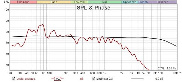

I took a few measurements of the ML EM ESL with the UMIK-1 connected to my Dell laptop. I took 3 measurements with UMIK-1 pointed at the speaker(with normal cal file), then without the cal file, and finally at 90 degrees with cal file for 90. Then I took 1 measurement with the Dell integrated mic(not calibrated). See results below.
39106
The Dell integrated mic is measuring much higher in dBs in the higher frequency range. I am starting to not trust the results from the miniDSP UMIK-1.

Relative to the gross absence of treble, those curves look pretty much the same to me and as far as I can make out anything in the tiny legend, make sense in their differences and add cred to your "lab skill".
Interesting you have separate calibration curves for straight and 90-degrees. You can open and read the cal files (at least on a Mac). How do they differ, just generally speaking?
Any chance your computer is using its internal mic for some or all the curves when you think you are using your mic? My MacBook sometimes does that if I'm not careful.
Please run a curve or do some freq spot checks on the electric signal going INTO the speakers. Confirming the input is an essential step.

I agree the trace for each measurement is similar but the diff in amplitude is what concerns me. I captured two images that contain each mic cal data trace. See attached examples.
I am certain the laptop's internal mic was only used when selected. I tested the feedback each time before I took a measurement.
I will get the freq measurement from the amp with my DVOM as requested. Will post later on this.

The height of the curves are of no importance since they reflect the connections and mixing and various amplifications and conversions etc along distinctive long paths.... unless you scrupulously matched them all to absolute levels using an SPL meter.
Thanks for posting the calibration curves. As you see, hardly worth losing sleep over using them or not up to maybe the limits of adult hearing about 14kHz - which is far above what many recording engineers can unknowingly hear. Being able to pinpoint sound levels over 8 kHz of little importance since it has little value in predicting your choice of house curve.
How about some data on inputs to speakers? Voltmeters aren't ideal for this measurement but certainly truthful enough to see if the input looks pretty flatish north of 2kHz.
