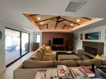

Yeah....acoustic treatment would be a challenge on a large glass door (and fireplace!)...see the pic of my room. Large sliding glass door on the left, concrete fireplace on the right. The MLs have very little side-radiation, compared to any conventional "cone" speaker. It's the midrange where the imaging gets confused. Piano solos seem to jump back-and-forth between the speakers, depending upon which note is being played.... probably due to side reflections. Take a look...the imaging is better if I open the glass door on the left...so I
know that's the culprit! View attachment 54272
I see what you’re saying…that’s a nice room, but you’d be pretty limited with acoustic treatments. Looks like it may be time for a new pair of speakers!:jump:

You might try asymmetric positioning which might tame the 'note' problem at the expense of the overall imaging

The photo already shows them asymmetrically positioned... What would be interesting to me would be to see some REW charts (.mdat) of the speakers in the room...

By asymmetric I meant relative to the whole room and shifting the MLP. It appears now that the speakers fire down the room. Perhaps swinging the speakers 30° CCW and moving the sub[?] between them. This assumes the mains are not part of the HT system. A floor plan would help immensely. It difficult to get a sense of scale from the exaggerated perspective.
