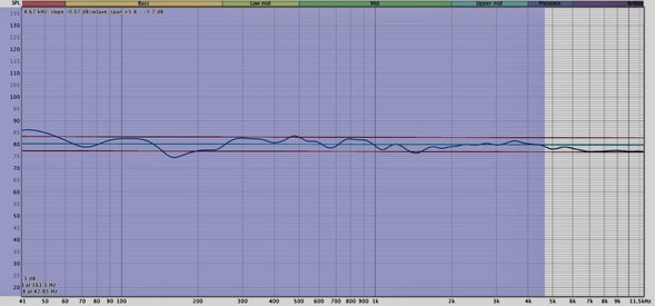

Much better, trace 5 and 6 look the same and are pretty good.
(spk72"Left only;sub180 Feb 11)
The way to tell is look at the 0 degree traces, set 1/48 octave smoothing, look for a deep dip at 55Hz meaning the sub and main are out of phase (the wrong phase)
so just set the phase switch to 180 and LISTEN! You might prefer the sub level a little higher say 9:30 or 10! Most guys like their bass level below 100Hz to be 3-4dB about the midband average.
Boosting the bass by adjusting sub level is not the best way to do it but it works OK then way we are set up.
You might hear a little thinness in the mid bass probably noticeable in chesty male voices. This is what we might be able to improve with targeted acoustic treatment.
Look at those good traces with psychoacoustic smoothing, that is much closer to what you actually will hear.
That is about as good as we can do until you get DSP and crossovers and /or room treatment.

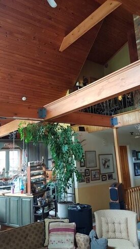

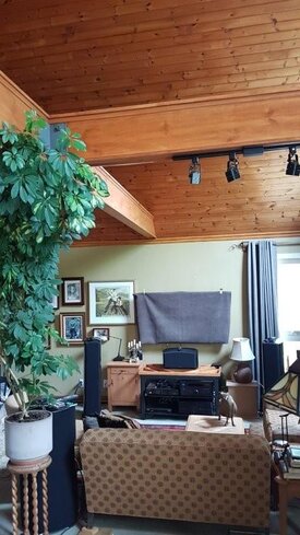

Every speaker / room/ placement combination will produce different results and require different settings. When you say you are pointing the speaker 55cm outside of the MLP do you mean that a line that passes through the center of the tweeter is pointing that far outside the center of the head? If so that may be right but seems a little far out. However, that is the whole point of this exercise. Whatever produces a sound stage that is the most realistic to you on the majority of recordings. It is best to use recordings that are made with the simplest possible microphone arrangement and those that are acoustic in nature. Studio recordings have the image generated in the mastering engineers head and vary a great deal.
You can try the signals and suggestions here I like #2.
[/QUOTE]
Exactly. The photos could help.
The MLP is at 251cm of straight line connecting the 2 front speakers (the base of the triangle if you prefer). Each speaker is 255cm from the MLP (the sides of the triangle). I aim with a laser aligned on the center of the tweeter towards the mlp and I open the angle little by little. I aim at 55cm on each side of the mlp. My Euclidean geometry lessons are too far back to remember how to calculate the angle!
To my surprise, the graph shows no significant difference between a toeing at 0, 25cm or 55cm in the mid-high range. (When my system was in a room in the basement of our house, it was a different story. The mid-high frequency response dropped drastically for a variation of only 20cm of toeing.)
You have sown in me the doubt which makes mad! :dumbcrazy:I went back to the exercise and tightened the angle to 37.5cm on each side of the MLP. My best result overall. Well defined PN signal image in the center in standard polarity and a well defined and stable hole (when I move my head from left to right and forward backword) in reversed polarity. With the music, the singer's voice well defined and the orchestra distributed in a wide SS&I.
Translated with www.DeepL.com/Translator (free version)
You have sown in me the doubt which makes mad! :dumbcrazy:I went back to the exercise and tightened the angle to 37.5cm on each side of the MLP. My best result overall. Well defined PN signal image in the center in standard polarity and a well defined and stable hole (when I move my head from left to right and front to back) in reversed polarity. With the music, the singer's voice well defined and the orchestra distributed in a wide SS&I.
Very nice room! Sounds like you have arrived at a good solution, congratulations!
